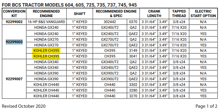

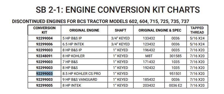

With the following BCS kit 92299003 you can swap engines listed below.   The Recommended engine is a CH395-3149 for pull start and CH395-3041 for electric. The CH395-3031 spec has the same 10 amp charging system as the original engine. Some wiring may be required for these.  Call us for more info.  1.800.888.7181
