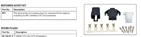

The RP1 kit is shown here:
This $20 kit will use the old wiring harness connector (cut 6-8” from the connector to the frame). Using the new 6 pin white Molex connector you will strip the wires and crimp the new bullet pins on to the wires. Insert the new pins into the white Molex connector to match the colors of the new engine.
This converts the old wiring pinout from the frame to the new engine without modifying the frame wiring or the new engine wiring. It is essentially a crossover or adapter cable made from the old engine harness.
