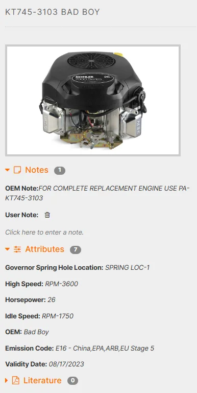

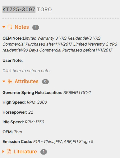

KT725-3097-->KT745-3103 JM-3209
Besides the RPM difference I notice the Air filter profile on the new engine is a HDAC. AS long as there is room for the ectra height of the filter you should be good to go with a RPM adjustment.
